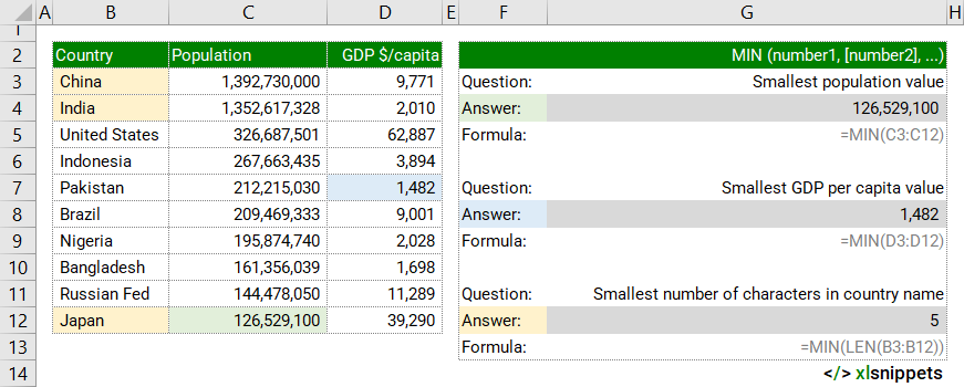

MIN examples.
In the examples below, the MIN function is used to identify the smallest population or GDP per capita values or even (using an array formula) the smallest number of characters in a selection of text strings.
Use the MIN function to return the smallest value in a range of values.
