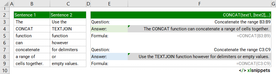

CONCAT with a cell range.
In the examples below, the CONCAT function is used to join a range of text together to form sentences. Spaces have been included after the relevant words as delimiters are not available in the CONCAT function.
Use the CONCAT function to join two or more text strings together from a range of cells.

=CONCAT(C3:C7) || returns the contents of cells in the range C3:C7. |

- Spaces may need to be added between or after values as delimiter arguments are not available.
- e.g. =CONCAT("South"," ","America") || space added as text value; returns South America.
- e.g. =CONCAT("South ","America") || space added after South; returns South America.
