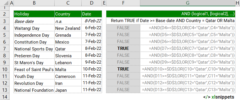

=AND(C2="Red",C3="Blue") || result is TRUE if cell C2 contains the text string "Red" and C3 "Blue" |
=AND(1=1,2=2) || result is TRUE as 1=1, 2=2 |
=AND(2/1/2022>1/1/2022,"3-Jan-2022">"2-Jan-2022") || result is TRUE for both serial number and text string dates |
=AND(TRUE,TRUE) || result is TRUE |
=AND(TRUE,FALSE) || result is FALSE |
=IF(AND(OR(A1="Merry",A1="White"),B1="Christmas"),A1&" "&B1,"") || result is "Merry Christmas" or "White Christmas" if the conditions are met or an empty cell if the conditions are not met. |
