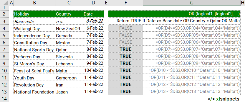

Return TRUE or FALSE statements based on testing multiple logical conditions
=OR(logical1, [logical2], ...)
Return TRUE or FALSE statements based on testing multiple logical conditions.
Return TRUE if any arguments are TRUE, FALSE if none of the arguments are TRUE.
OR syntax requires at least 1 argument, a logical condition. Up to 255 logical conditions can be tested with this function.
OR with text.
In the examples below, the OR function is used to test multiple text strings.
Use the OR function to return TRUE or FALSE statements based on testing text strings against multiple logical conditions.
OR with numbers.
In the examples below, the OR function is used to test multiple numbers or cell references with numbers. Statements are also returned based on the result of an OR function combined with an IF function.
Use the OR function to return TRUE or FALSE statements based on testing numbers against multiple logical conditions.
OR with dates.
In the examples below, the OR function is used to test multiple dates (essentially formatted serial numbers) and text strings.
Use the OR function to return TRUE or FALSE statements based on testing dates against multiple logical conditions.

OR can be inserted into calculations to test multiple conditions.
=OR(C2="Red",C3="Blue") || result is TRUE if either cell C2 contains the text string "Red" or C3 "Blue" |
=OR(1=1,2=2) || result is TRUE as 1=1 or 2=2 |
=OR(2/1/2022>1/1/2022,"3-Jan-2022">"2-Jan-2022") || result is TRUE for both serial number and text string dates |
=OR(TRUE,TRUE) || result is TRUE |
=OR(TRUE,FALSE) || result is TRUE as one argument returns TRUE |
=IF(AND(OR(A1="Merry",A1="White"),B1="Christmas"),A1&" "&B1,"") || result is "Merry Christmas" or "White Christmas" if the conditions are met or an empty cell if the conditions are not met. |
