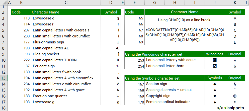

CHAR(10) returns a line break. For example, ="This is the first line"&CHAR(10)&"This is the second line" will return the 2 sentences on separate lines (enable word wrap within the cell to view the results).

In the examples below, the CHAR function is used to generate different characters. Note that the use of different fonts further expands the range of characters that can be used.
Use the CHAR function to return the character specified by a number.
