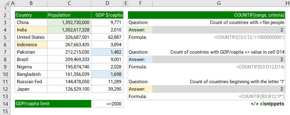

In the examples below, the data range shows a list of countries along with some population and Gross Domestic Product (GDP) per capita statistics. COUNTIF is used to count how many countries meet set numerical, logical or text criteria.
Use the COUNTIF function to count values in a range that meet a single criteria.
Note: COUNTIF works slightly differently to the COUNTIFS (with the 's'!) function which allows you to count values associated with multiple criteria. For example, with a COUNTIFS function, you could count the number of countries in a specific region that also matched specific population criteria. This would not be possible with the COUNTIF function which only permits one criterion.

=COUNTIF(C3:C13,"South Asia") |
=COUNTIF(Region,"South Asia") |
=COUNTIF(Table1[Region],"South Asia") |
=COUNTIF(C3:C13,"<>South Asia") // not equal to "South Asia" |
=COUNTIF(C3:C13,"*Asia") // ends with "Asia" |
=COUNTIF(C3:C13,"?????") // contains 5 characters |
=COUNTIF(C3:C13,"<>"&A2) // not equal to value of cell A2 |
