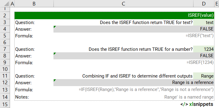

ISREF with text strings or numerical values.
In the examples below, the ISNUMBER function is used to determine whether cells contain references or not.

=ISREF(1/0) || result is FALSE as the cell is not a reference. |
=ISREF(#REF!) || result is FALSE for an error message. |
=IF(ISREF(XLSNIPPETS),"Named range XLSNIPPETS exists","Named range XLSNIPPETS does not exist") || when ISREF is TRUE, the result is "Named range XLSNIPPETS exists", otherwise it is "Named range XLSNIPPETS does not exist" |
