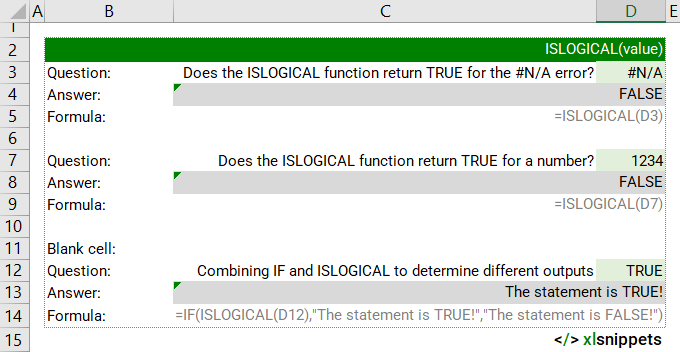

In the examples below, the ISLOGICAL function is used to determine whether cells contain a TRUE or FALSE statement.
Use the ISLOGICAL function to return the logical value TRUE if a cell contains a TRUE or FALSE statement.

=ISLOGICAL(1/0) || result is FALSE as divide by zero triggers a #DIV/0! error not a TRUE or FALSE statement. |
=ISLOGICAL(C7) || result is FALSE if cell reference C7 does not contain a TRUE or FALSE statement. |
=IF(ISLOGICAL(C7),"Statement is TRUE","Statement is FALSE") || when ISLOGICAL is TRUE, the result is "Statement is TRUE", otherwise it is "Statement is FALSE" |
