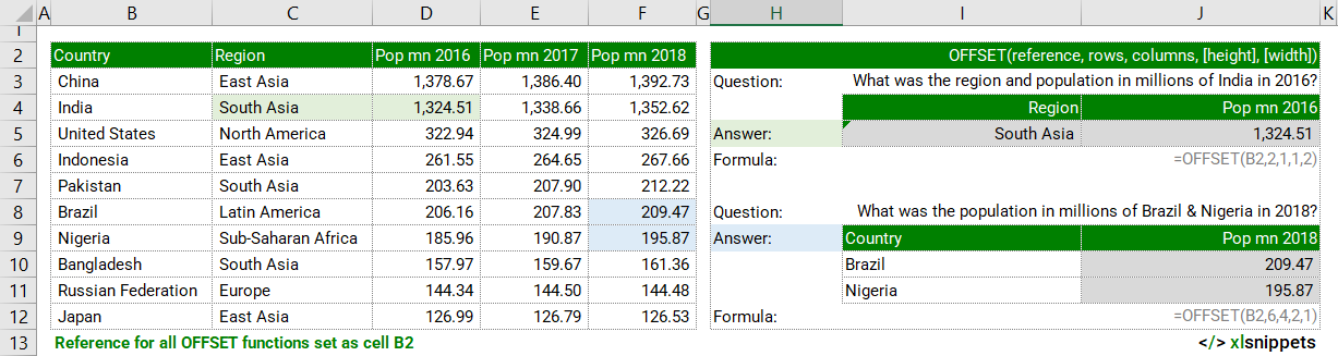

For example, =OFFSET(B2,2,2,1,1) will return a single reference 2 rows and 2 columns away from the starting point cell B2 (i.e. cell D4).

In the examples below, the OFFSET function is used to return population data for specific countries. Note the use of the MATCH function in the rows and cols arguments which can help create a dynamic formula.

=OFFSET(B2,2,2,1,1) || result is a single value from cell D4 which is 2 rows down and 2 columns across from the starting point cell B2. |
=OFFSET(B2,2,1,1,2) || result is 2 values from cells C4 & D4 which are 2 rows down and 1 column across from the starting point cell B2. |
=OFFSET(B2,6,4,2,1) || result is 2 values from cells F8 & F9 which are 6 rows down and 4 columns across from the starting point cell B2. |
=SUM(OFFSET(B2,1,2,5,1)) || result is sum of values in range D3:D7 which is 1 row down and 2 columns to the right from the starting point cell B2 and has a height of 5 rows. This would be the same as =SUM(D3:D7). |
