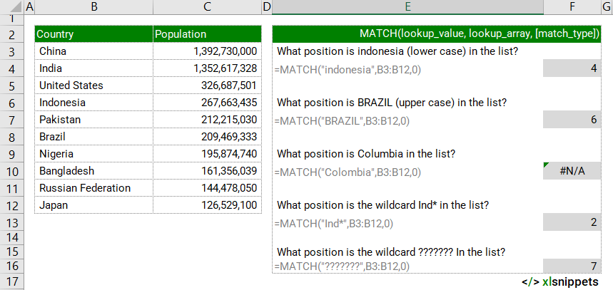

In the examples below, the MATCH function is used to match country names to a list. The lookup_values are case insensitive. #N/A is returned for values not found in the list and wildcards (* ?) are accepted.
Use the MATCH function to return the relative position of a specified item in a range.

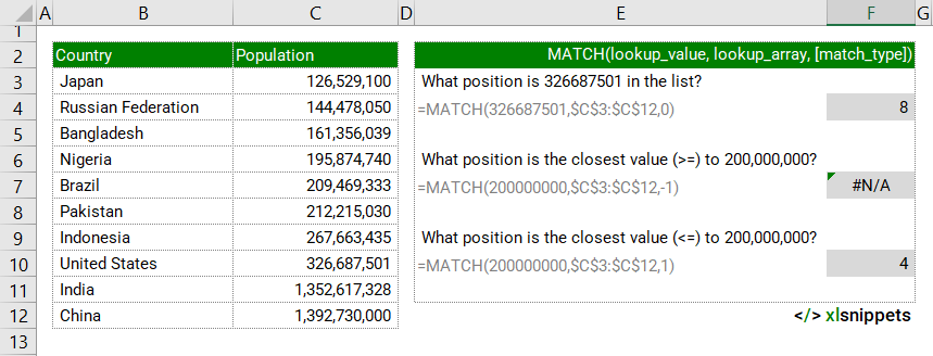

In the examples below, the MATCH function is used to match country populations to a list in ascending order. A match_type of 0 returns exact matches. -1 returns an exact match or next largest value but needs the list of numbers to be in descending order so returns the #N/A error in this instance. 1 returns an exact match or the next smallest value - the list of numbers is in the required ascending order.
Use the MATCH function to return the relative position of a specified number in a range.

=MATCH("indonesia",B3:B12,0) || result is the position of the lookup_value "indonesia" in the lookup_array B3:B12. MATCH is case insensitive, not distinguishing between upper and lowercase letters. |
=MATCH(326687501,$C$3:$C$12,0) || result is the position of the lookup_value 326,687,501 in the lookup_array C3:C12. The #N/A error value is returned if no exact match (based on the optional match_type) is found. |
=MATCH(200000000,$C$3:$C$12,1) || result is the largest value from the lookup_array C3:C12 that is less than or equal to the lookup_value 200,000,000. The values in the lookup_array must be in ascending order. |
=MATCH(200000000,$C$3:$C$12,-1) || result is the smallest value from the lookup_array C3:C12 that is greater than or equal to the lookup_value 200,000,000. The values in the lookup_array must be in descending order. |
