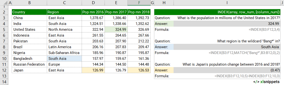

For example, the array formula =INDEX(B3:F12,3,4) will return the value from the range B3:F12 that is 3 rows down and 4 columns across.

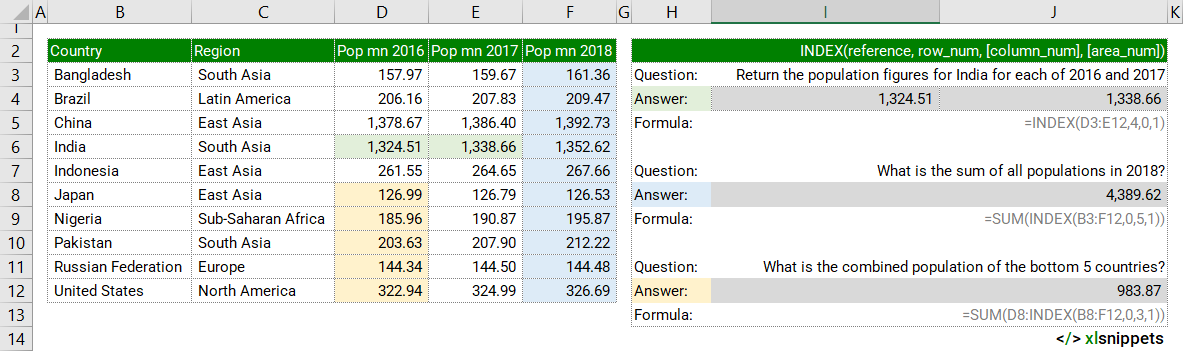

The reference formula =INDEX(D3:E12,4,0,1) will return the array of values in the range D3:E12 that are 4 rows down.
Dynamic row and column references can be created by applying the MATCH function. The array formula =INDEX(B3:F12,MATCH("Bang*",B3:B12,0),2) will return the value from the range B3:F12 that is in the row that exactly matches the wildcard value of "Bang*" (e.g. Bangladesh) and 2 columns across.
INDEX: array form.
In the examples below, the INDEX function is used to match population data by year to specific countries and perform calculations on population data. Note the use of the MATCH function and wildcards.

INDEX: reference form.
In the examples below, the INDEX function is used to return arrays or the sum of population data for one or many countries.
Use the INDEX function to return the reference of specified cell(s) at the intersection of particular rows and columns.

=INDEX(B3:F12,3,4) || result is a value from the range B3:F12 that is 3 rows down and 4 columns across. |
=INDEX(B3:F12,MATCH("Bang*",B3:B12,0),2) || result is a value from the range B3:F12 that is an exact match for the wilcard "Bang*" and is 2 columns across. |
=INDEX(D3:E12,4,0,1) || result is all values from the range D3:E12 that are 4 rows down. |
=SUM(INDEX(B3:F12,0,5,1)) || result is the sum of values from the 5th column across in the range B3:F12. |
=SUM(D8:INDEX(B8:F12,0,3,1)) || result is the sum of values from the range D8:(the 3rd column across in the range B3:F12). |
